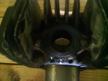

Here is a pic of the A5 cylinder after my porting : Afbeelding

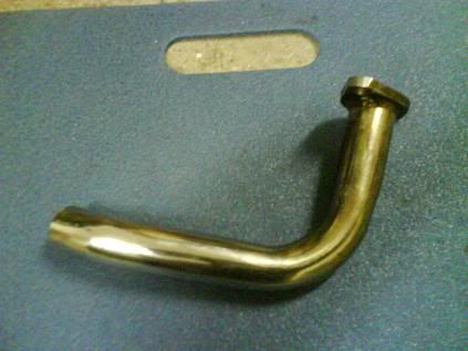

But I don't understand. Did the angle change on the Flexer model? 2006- and newer?
This is how mine looks like:

Berichten: 9687
Berichtdoor shadowranger » 03 okt 2010 12:26
And does the first part before the curve stay perpendicular to the ground when you only mount this to your cilinder? If yes, than it's the right, if no maybe the exhaust port is angled (like an A55 cylinder) and you need to , or bend this frontpipe, or buy an other exhaust that will fit proparly.
Could you post a picture when this frontpipe is mounted to the cilinder? And maybe a photo of the rest of the exhaust and the mounting at the rear?

Berichtdoor granturismo » 03 okt 2010 16:38
Nope, the original cylinder exhaust port is not aligned to the ground. Its an angle.. higher towards the front wheel. Comparing to a friends Quadro 2003 wich also has A52 block but this port is exactly horizontal, same as the Airsal on my moped.
So I will be ordering an A35 exhaust :)
Berichten: 9687
Berichtdoor shadowranger » 03 okt 2010 21:26
So now you have this Airsal cylinder wich has the exhaust port aligned to the ground or not? If your exhaust port is still angled (toward front) you need A55 exhaust.
I'm a bit confused. You say original cylinder has angled exhaust port. So why can you say that your Flexer has an A52 engine? In my opinion the only engine with an angled exhaust port cylinder is A55. But now with your Airsal it's proparly aligned to the ground? How can the frontpipe leak like in the picture? Or does it because your suspension at the rear has different measures (euro 2 instead of euro 1), eg. 2 or 1 hole.

Berichtdoor granturismo » 03 okt 2010 23:45
Original cylinder = Tomos Flexer 2006 = angle
Airsal cylinder = no angle (aligned to the ground)
I don't have the A55 engine. I got reed valves. Also A55 cylinder is alu-color. Mine was black (like A35).
My upgraded exhaust leaked because I was in a hurry, and didn't notice the angle difference between the two cylinders. Hence I got a gap after mounting it to the Airsal cylinder. :)
