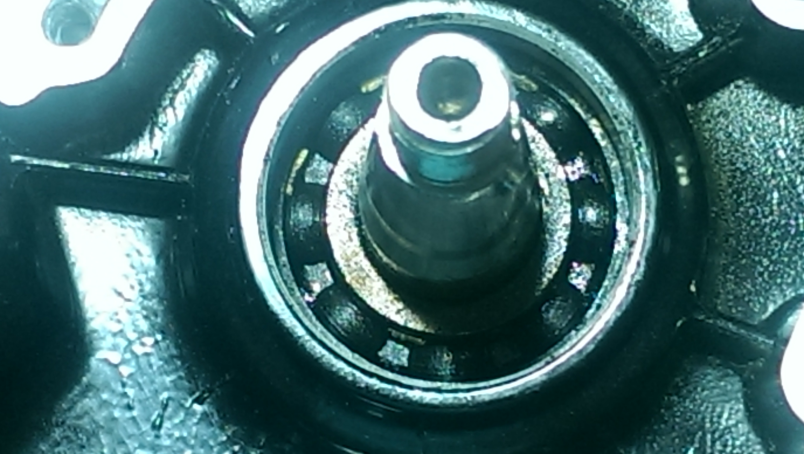

Re: Hello from LE, my first Tomos
Geplaatst: 11 feb 2022 22:07
door Wolfram
Hi Fons, thx for the link. Describing exactly my problem.
The bad seal on the ignition side is out. But on the other side the M10 screw of the crankshaft cannot be removed. I fixed the piston with the stopper but the screw doesn't move at all.
Geplaatst: 12 feb 2022 00:37
door shadowranger
Is there a washer which has 1 side flipped up to one side of the nut to prevent it to loosen? Otherwise you just have to use more force (turning left). It could be set very firm.
If you don't want to use a piston blocker, you can block turning the cranckshaft using a tool on the flywheel or an airgun.
Geplaatst: 13 feb 2022 08:57
door Wolfram
Hi shadowranger, finally the nut gave up after plenty of heat with the heat gun.
Could remove the three wheels and replace the sealing. I also saw the famous vraagteken veer. Looks good.

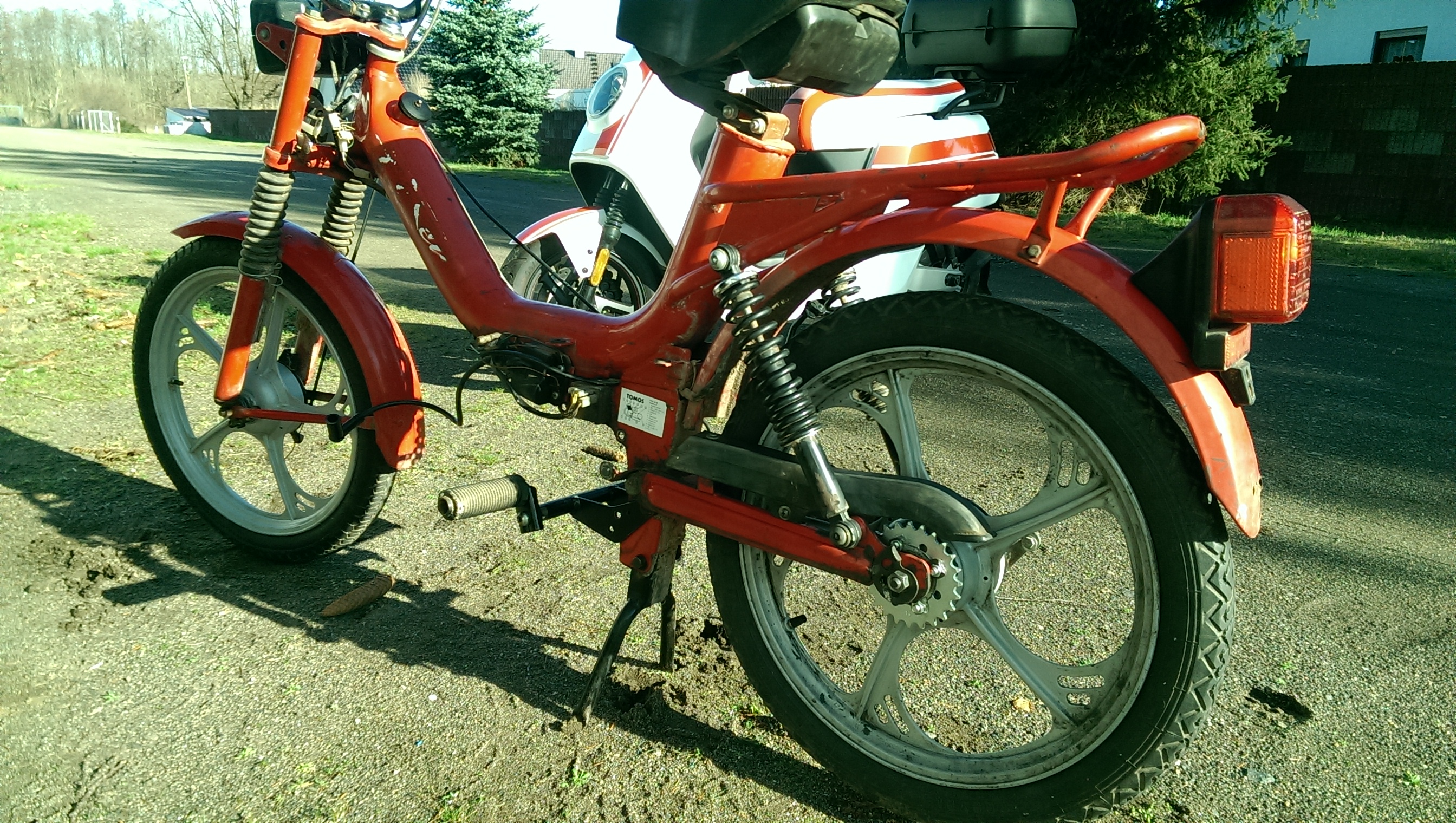

Geplaatst: 20 feb 2022 19:32
door Wolfram
Update - the tank is clean, the motor is installed and has a nice, strong spark.
Only the exhaust pipe has to be installed to be ready for test run. I am very interested how it will start.
To be continued...
Geplaatst: 20 feb 2022 20:46
door fons716
I miss the tank vent under the seat, when refueling an air bubble accumulates there so that less fuel can enter the tank.
Without the exhaust it should also start, only makes a lot of noise which is not nice for the neighbors.
Geplaatst: 22 feb 2022 20:58
door Wolfram
Hi Fons,
the valve for the tank is on the other side of the moped. And you are right, the exhaust has to be installed, I like my neighbors
Geplaatst: 23 feb 2022 10:02
door fons716
I have not seen that here yet, the valve is here at the front under the saddle.
Hence the comment because I didn't see it.
Geplaatst: 26 feb 2022 19:29
door Wolfram
Update
I fixed the exhaust somehow. The original screws from airsal are trash. Also found that valve for the tank.
Some problems with the fuelvalve. Difficult to reassemble. But got it finished. Filled fresh gasoline. One kick...... Running
nice engine.
But the seal between cylinder and exhaust doesn't fit. Too much noise. To be continued...
