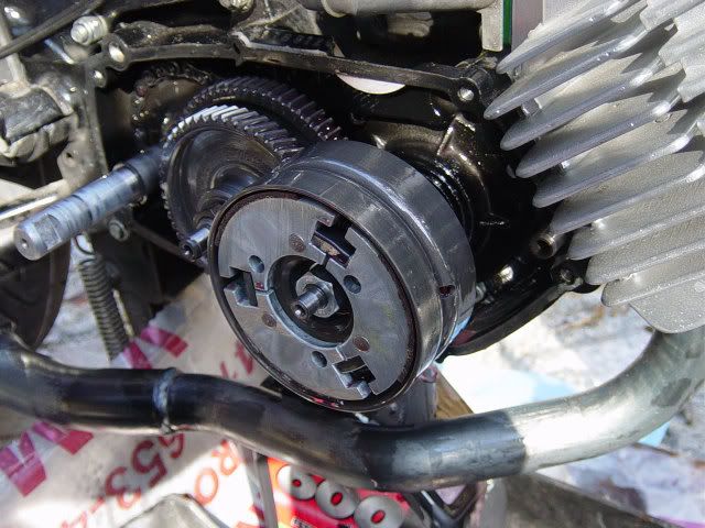

Im also going to shorten the clutch springs... here is a pick of the crankcase open:
How does the clutch pads look? Worn out?
Also, the nut that holds the clutches inplace... which way do i unscrew it? clockwise or counter?

The first clutch pad looks a little worn out indeed. But it'll be ok
With a 22 rear sprocket, your moped shifts at more revs.
So your clutch wears out faster.
( I don't know if the word ''wears out'' is right )

it looks good enough to me.
unscrew te nut leftwise, counterclockwise.

the clutch is still alright... :wink:

does he have pedals or an kickstart, if it is kickstart he has his kickstart on the right side :twisted: not on the left like us :P

Pedals... You can see it clearly @ 4th picture on the first page.

o jeah, but it looks like to me that you can not turn the pedals 360 degrees begause of jour exhaust
