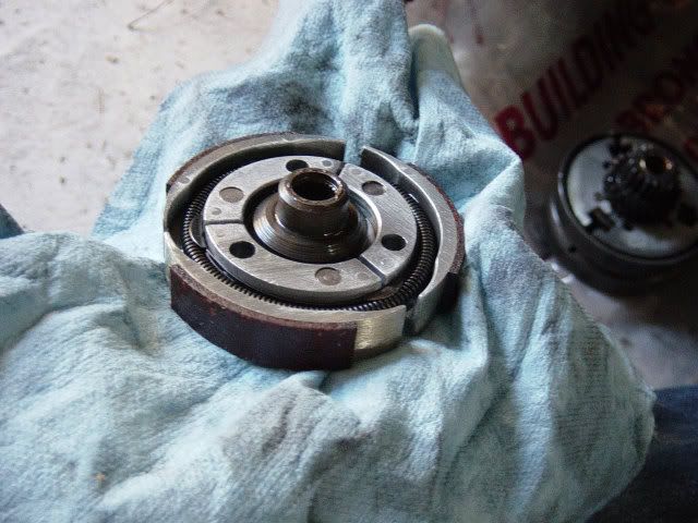

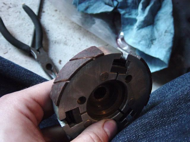

I took apart my tomos today, removing the 1st and 2nd clutches. The first thing i did was remove the spring and shorten them both (for each clutch) by 1cm. I then put them back on and then cut 2 slits per pad (45 degree). It helps a hell of a lot. But be worned, without the proper tools (like i did) it is hard to do this. The two most difficult tasks in this process was 1) putting back the clutch springs... wow was that hard! 2)taking off and later putting on the washer that holds in the 2nd clutch.... whoa... if i had the right tools it would have been a breeze. After all is said and done, I am very very pleased with the results!
here are some pictures:
(Did this for both clutches)
I gotta say, this performance increase is at about the same improvement level as going from a stock pipe to a tecnigas. ****, I accelarate like a mad man now.

whats thats stripe on your clutch shoes :?:
have you did this by yourself :?:

Ya, i cut diagnal groves into the clutch shoe so that the transmission oil on the pads has a quicker escape route.

thats smart.
about 1 week i go buy an 2speed engine en i need to add de spring clutch to zo i am planning to make diagnal groves to than :wink:
does you have make inprovement with the groves?
kreidler powur in et schuurtje

I cant say for sure the grooves help, cause the improvement i am noticing could also be from shortening the springs. Here are my observations after riding it out today:
There is a lot of punch when you are at a stand still and accelerate. Its fun to feel the G force pulling me back. The 2nd gear engages at around 25km (down from the 30-35km/h it was before). The change over from one gear to the other is silky smooth.. Its easy to not even realize when it takes place.
I accelerate steadly till around 50km/h at which point i feel a stronger pull (accelerating) till around the "M" of TOMOS on the speedo, which is around 70km/h.

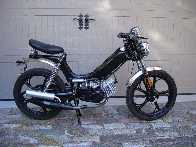

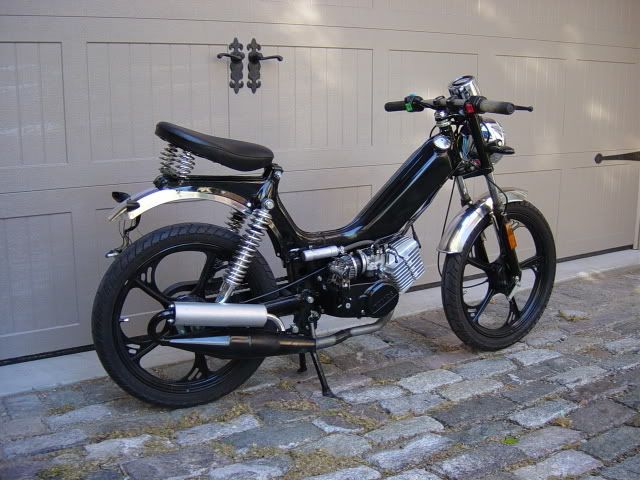

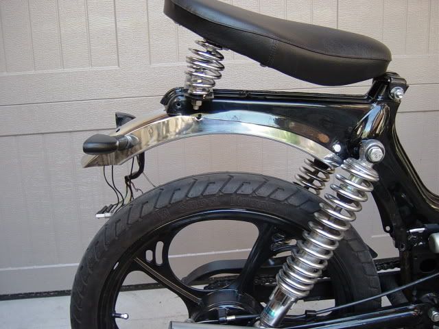

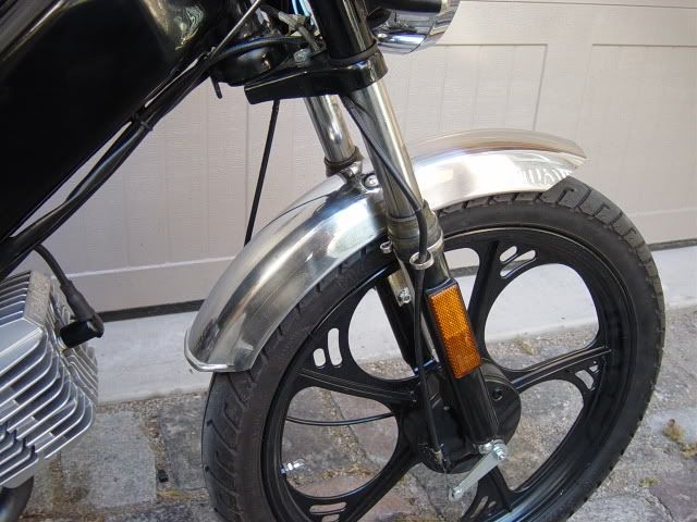

I got the chrome fenders a few days ago, and have cut them to size. Here is an update of how it currently looks. Got a new tail light, (which i had to paint a bit... so is now drying in the sun). I will post new completed pics in a few days.

Damn nice :D!
I like it man :)
Keep it going
Tossie
Pro Forummer
Berichten: 1938
Lid geworden op: 21 mei 2005 15:43
Locatie: Amersfoort
Berichtdoor Tossie » 08 mei 2006 09:33
Wow, black & chrome really shows off.
